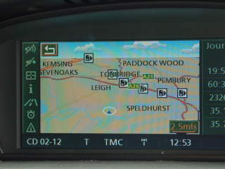

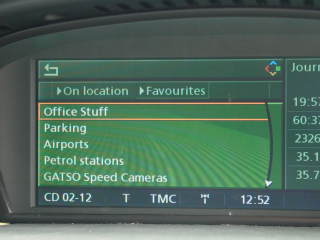

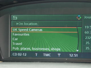

Here's the results of my "groups hack". I've successfully added 2 groups. One for speed cameras, and one for favourites.
I created a list of company offices. Using postcodes, I translated them into long/lat using SteetMap.co.uk, and then created my own ASC file, and company logo (gif). Not because I need it, just because I could
Main menu:
Speed Camera menu:
Favourites menu:
Screenshot of gatso cameras:
Screenshot of redlight cameras:
