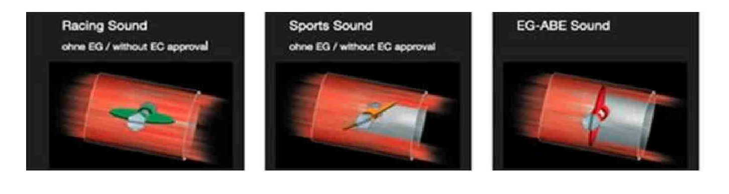

I wonder why not others brand name use the adjustable valve for control over sound. Then customer can make whatever they like.
Just idea only

the valve would cause a restriction in exhaust flow, creating a reduction of power. Since RPi believes in creating maximum power, the valve would be contrary to what they believe in. This is a great option for members who want the power but don't want the awesome sound!

I don't think this is completely true. Some exhausts have this valve to create more back pressure at lower revs which provide more torque and it opens up at higher revs to increase flow.
Then again, the valve is also there to limit sound output to satisfy regulatory requirements.
