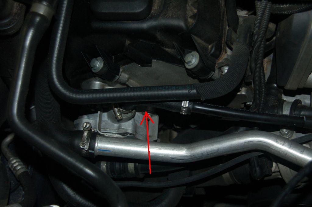

Originally Posted by dawid_w' post='1065972' date='Dec 1 2009, 07:45 PM
I had to replace the brake booster also
Did you check brake booster vacuum hose ?
Item number 5 - it goes from the booster all the way to the vacuum pump. It is made 90% from plastic, but there is a rubber connector just before the vacum pump. It cracks in the buttom
http://www.realoem.com/bmw/showparts.do?mo...hg=34&fg=25
Attachment 95307
Attachment 95307

Originally Posted by 05545i' post='1066101' date='Dec 1 2009, 10:03 PM
That hose is OK. Doesnt look like there is anything wrong with it.
Do you have any problems with the brakes?
