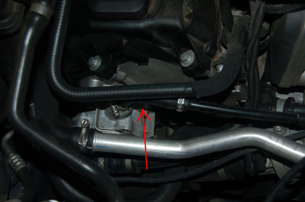

For these who had to replace the brake booster, what was the reason/symptom?

I had to replace the brake booster also
[/quote]
Did you check brake booster vacuum hose ?
Item number 5 - it goes from the booster all the way to the vacuum pump. It is made 90% from plastic, but there is a rubber connector just before the vacum pump. It cracks in the buttom
http://www.realoem.com/bmw/showparts.do?mo...hg=34&fg=25
What kind of mileage do you guys have on your 545/550s?  Probelms alon-vacuum_hose.jpg

I'll have to check that when i change the brake fluid.
This is in front of the engine. Open the hood on the left side (below radiator reservoir)
At the low speed it was very hard to press the brake pedal. At high speeds or high RPMs no problem... It was loosing the vacuum pressure.
But check the vacuum pipe first.
You can buy the TRW (OEM) brake booster at http://www.partsgeek.com/
It is the same part but no BMW logo ;-)
