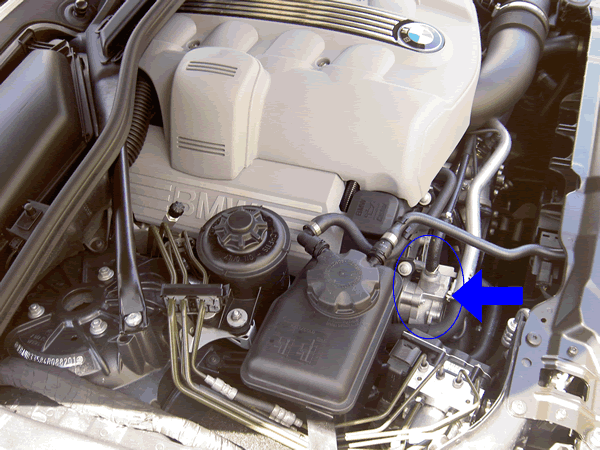

Ok guys I bought the mechanic's sthethoscope and followed the noise to a part that I honestly dont know what it is when the car is warm you can barely hear it I am posting a picture of the part that is producing the noise I hope someone can guide me on what it could be before I have to go to the shop.
Thanks
Auxilliary Vacuum Pump. Check this link: https://5series.net/forums/topic/912...oil-how-common
Thank you so much for the response, good news I guess is that I have no leaks just the noise do you think its something I should be concerned right away or not. I love how the car drives and I will hate to cause any more damages to it for not taking care of the problem soon.
Thanks
Let me put it this way. This is the little sucker that create the vacuum for your power brake booster. If this unit fails, no vacuum, no power brakes. Remember that whole recall fiasco not too long ago with our V8 E60s? Well, unfortunately, during the recall repair, BMWNA will replace everything but the pump. I'd start putting money away to buy a new pump which I think is about $425 depending on where you get it. It's seemingly a simple task to replace it tho. Good luck!
I will def start saving for it and replace it asap you are right i dont want to loose my brakes at 100mph lol. Thanks again for all your help
