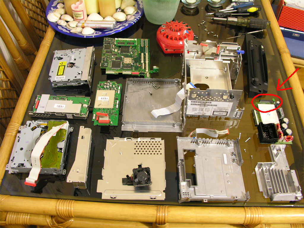

WOW WOW, HEHE, I fixed the audio problem, it took me the whole day today, Haha!!
My CCC in pieces. The problem was at the DSP board (de-soldered contacts) where it connects to the amplifier part.
Hi Nick,
Congratulations, well done, looks like a dry solder joint. I'm trying to workout if it's something I'd do, I'll tackle almost anything. Unfortunately, it does appear that some of the parts on eBay may be defective.
