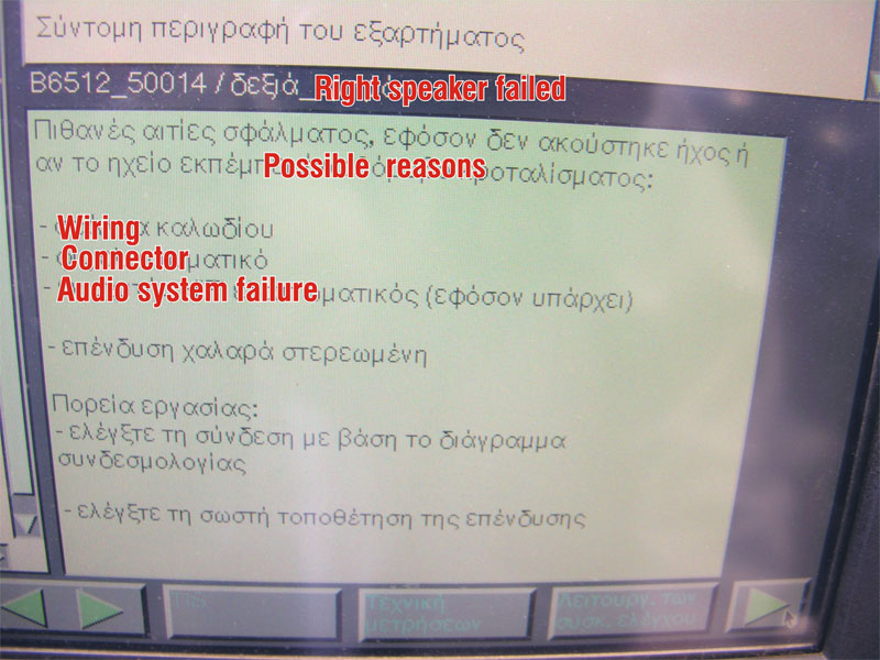

We did a test with DIS Plus on the fan and the audio channel as well.
See pics below.
