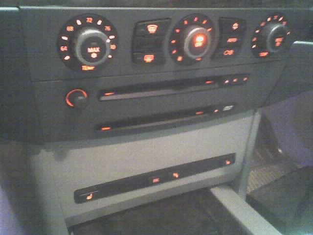

how do i remove this???

the gray area with the buttons in it. i want to see if i can place a flip out tv/dvd player in the hole. i know if you dont have nav there is a open area to put thing in

I'm pretty sure that there is a computer component behind there which is why you lose the storage compartment with nav.
I'll check TIS as soon as I can and see if I can find more specifics...

Okay, I think I found the instructions. You're not going to like them. Apparently, the lower (gray) piece is clipped (from behind) to the upper darker colored piece that has the slots for the discs.
In order to remove those two, you need to remove the wood strip and the center & passenger side vents. It requires special tools that include an assortment of wedges and things to remove the trim panels.
I could post the detailed instructions but after all this, I'm still pretty sure that there is a big fat silver CCC computer module located directly behind this gray panel.
