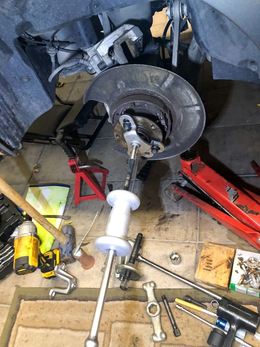

Quite some time ago I invested in a blue point hub puller kit - with some determination, I managed to do mine.
