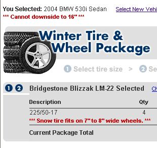

so any other members who can personaly confirm regular tire swap on "RF"-rim?
also anybody knows if a 225 wide tire will fit 17" 122style wheel where 245 size is now? I believe it is 8J size rim
Old Oct 2, 2005 | 04:31 AM
  #40
Peter530i's Avatar
Posts: 1,934
well so I did some research on our favourite tire shop and here is an answer about the sizes for 17" 122style BMW wheels.
Yes, width 225-245 will fit Good. Now I can order regular non-rf winter tires for those wheels
Love this forum, AKA "BMW specialists Bible"
