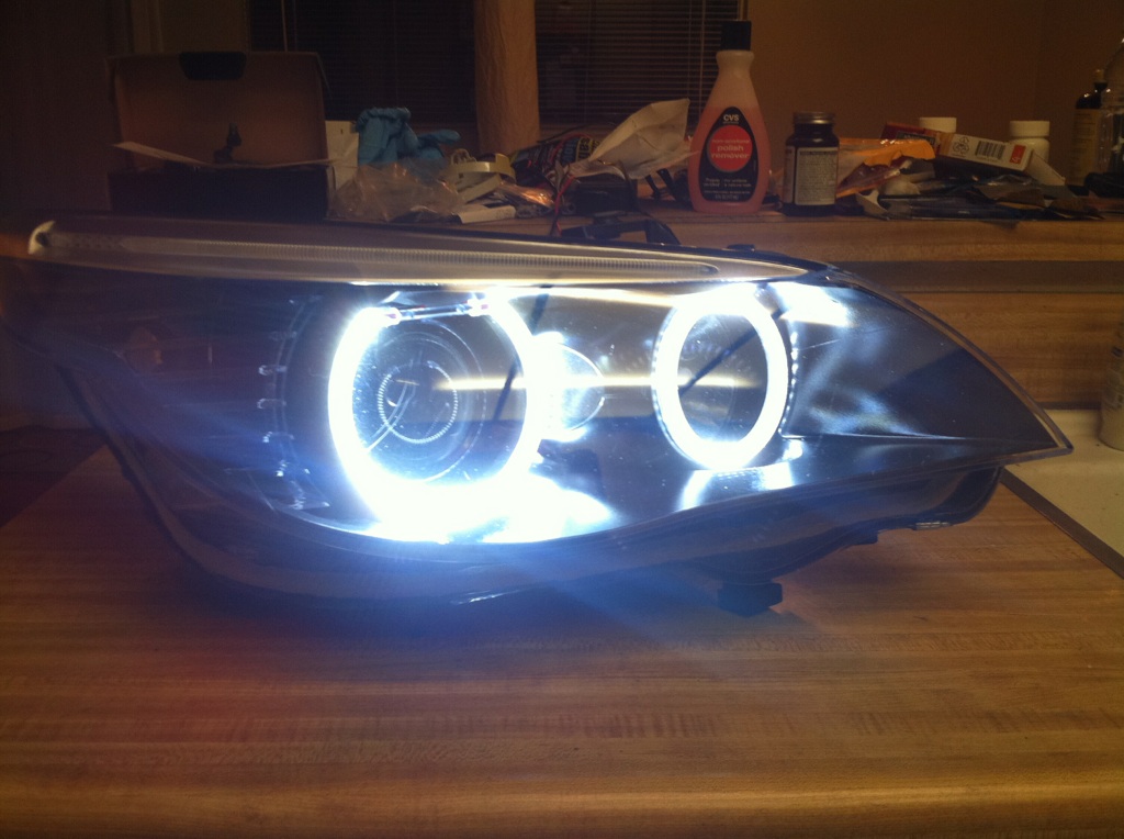

def orions is way to go guys... just got mine installed by simon aka genius aka nomis_nehc
with clear lens swap and gloss blacked out... can't wait to see them in person
