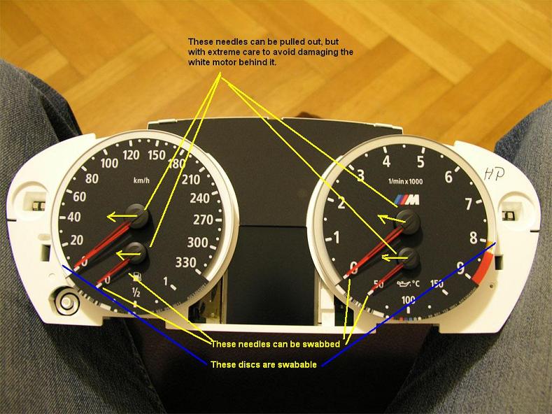

Originally Posted by nicke60gre' post='495597' date='Nov 17 2007, 09:20 AM
It's not just the LEDs. It's the red transparent needles, the alu outter rings and the alu round indicators as well (cruise control - rev limiter) that makes that huge difference.
Hi Nick,
1. Red transparent needles can be exchanged (not sirynge needles, OK! ). I can be pulled out and pop back it. But the catch is we might brake the white motor.
2. We can use the M5 cluster casing so you can still have the outer aluminum ring.
3. By removing the needes, you can swab the cruise control and rev limiter discs.
LEDs are really small to solder
M5 / M6 cluster-m5_3.jpg

Originally Posted by my530i' post='495684' date='Nov 17 2007, 10:55 PM
Hi Nick,
Attachment 40639
Fred, it's not an easy job to remove the needls, I've tried with no success. Needle seem to be sticked to the axle, I'm afraid that if I put some more force, I will break the motor inside.

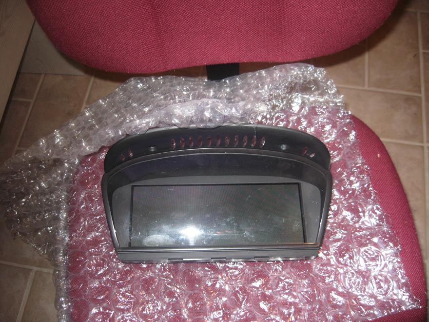

I thought I received M6 cluster today, but it turned out they sent me wrong part They stole my Thanksgivings.
