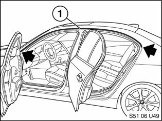

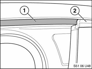

I tried adding electrical tape to the areas shown on the picture and it works no more wooden ship sound.
Attachment 96659
Attachment 96658
I've always wondered if electrical tape would work!!! Well, good for you that it worked and it probably won't be THAT noticeable since your car is black!
Whereas, if I didn't have the teflon tapes put on by the dealers, I would probably hesitate to put the electrical tapes on because my car is blue!

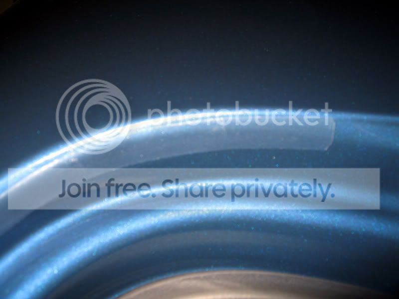

Originally Posted by Small Tomato' post='1089619' date='Jan 13 2010, 08:21 PM
Oh an update, when I took my car for oil service, the service advisor has applied this clear tape for me so the noise is gone permanently, free of charge
Did yours look like this?
This is from my car... it is clear and the noise is gone permanently... but I just wanted to purchase some just in case for the future... but they were asking $200!
I think it's very similar to yours. Just my car is in platnium bronze colour so it's not obvious than darker body colour
