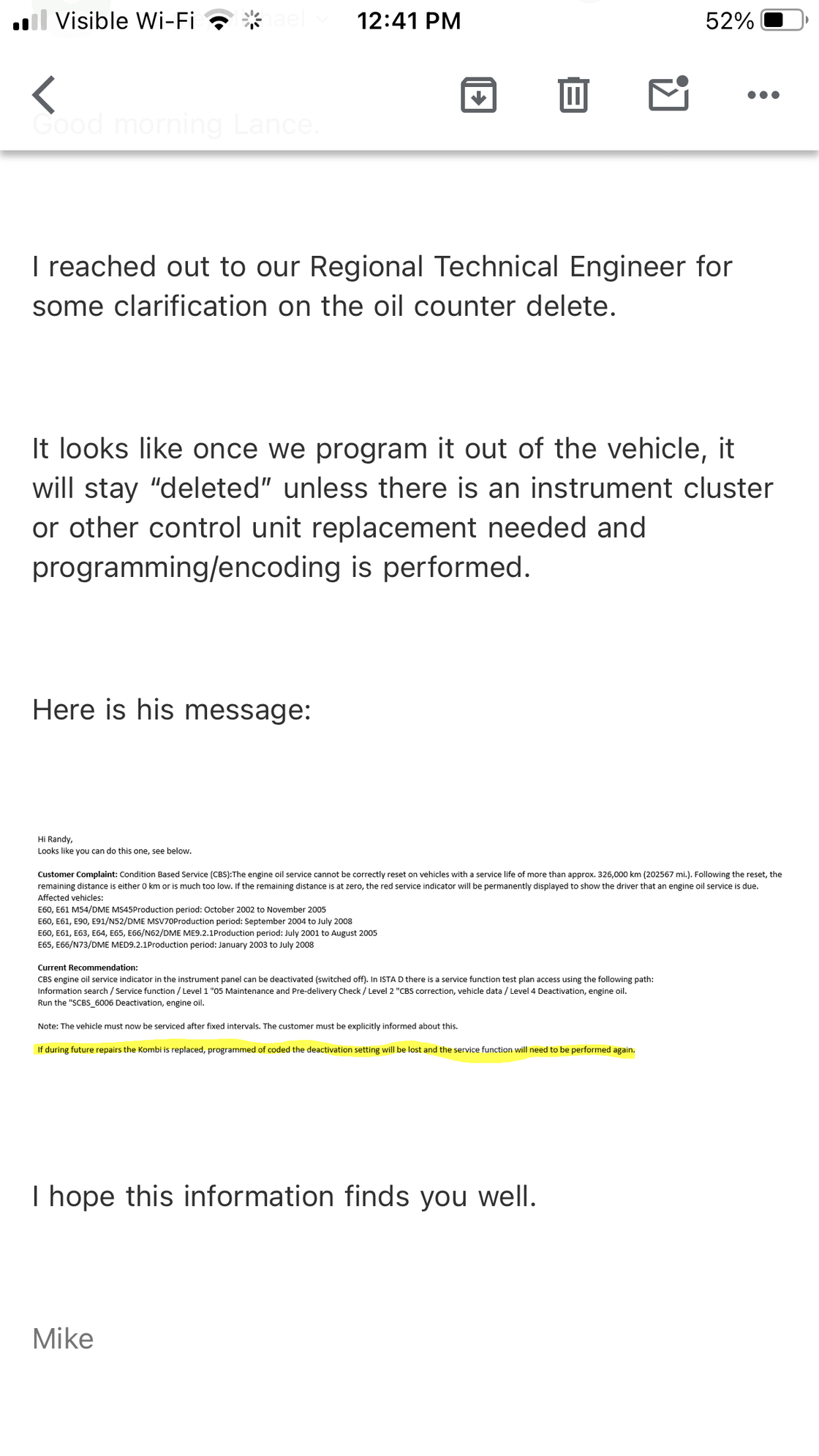

Default Models that issues with oil reset light after 186k miles, dealer notification
Dealer quoted me $285 for oil service reminder light delete. Here is attachment from medford bmw dealer from engineering dept. there is a proper procedure to do the oil service reminder delete

Default Dealer bulletin for oil service light delete
Bmw engineering dept request from medford Oregon BMW dealer. Was quoted $285 from dealer to perform this procedure, even after I had oil change performed at dealer.
