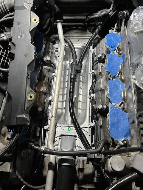

Default Knock sensor error

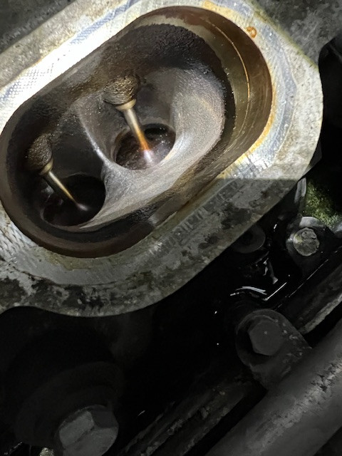

After work done this was resolved.
I haven't reached to the point of using INPA/WINKFP yet but very close, so decided to go with parts replacement.

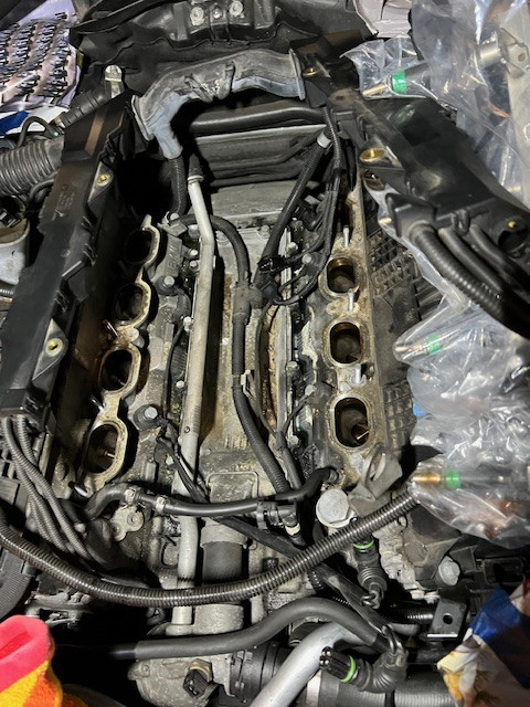

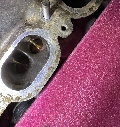

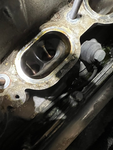

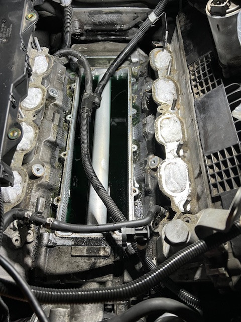

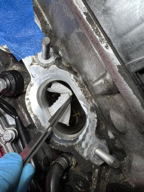

Waited for arrival of valley pan, knock sensors and some other parts that are in related area, completed replacement (valley pan was leaking), knock sensors both sides, replaced cam shaft sensor O rings and covers on larger sensors. cleaned non-return valves/replaced O rings, cleaned fuel injectors/replaced O rings, cleaned solenoid valves/replaced O rings, cleaned throttle body replaced O ring including intake manifold gaskets, intake valves appeared very clean for 160K mileage just cleaned a bit the top areas of intake port walls.
Cleared the errors with Carly app.
The error was related to knock sensors, after replacing with new ones no error code.
