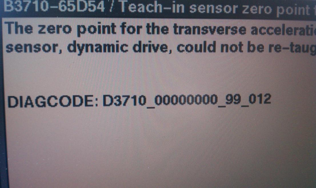

I've had a DSC issue for sometime now. At first the problem was with the steering angle sensor, it could not be re-calibrated. I had the sensor replaced at the dealer but now I am getting the error for the transverse acceleration sensor. I tested it and it was dead, so I replaced with a used one.
I thought all I had to do was replace it but after replacing the sensor I got DSC malfunction as soon as I drive for a few minutes. I displayed all the readings from the senor using GT1 so I know the senor is operational. I read somewhere that I had to relearn zero point for all sensors in DSC. I was able to re learn front and rear axle sensor but not acceleration senor. I've attached a pic below.
I don't know if the issue is with the DSC control unit or the sensor.
Anyone have any ideas?

Anyone think recalibrating the steering angle sensor would help? This thing gets really annoying.
