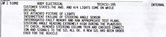

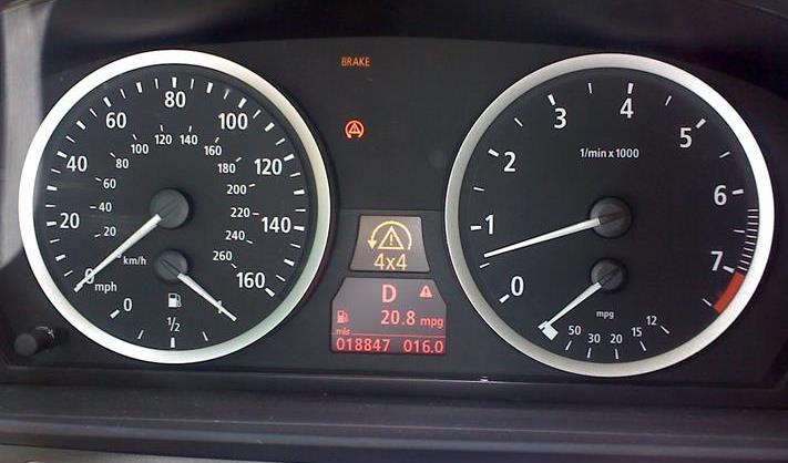

Originally Posted by gs_535xi' post='656905' date='Aug 29 2008, 02:37 AM
I just started the car right now and a yellow trangle with a arrow around it and a 4x4 sign under came upp !! it says show it to the deallerrr... Can some 1 please tell me more about this asappp I had plans for the weekend
I didn't read thru to the bottom of this post but this previously happened on my '07 530xi. It was an intermittent failure of the Steering Angel Sensor. Replaced and recoded the car. All is fine.
It was a week before they had the replacement part and I could get it in for service ... it drove OK - no drama!

Originally Posted by gs_535xi' post='658741' date='Aug 31 2008, 11:15 PM
Thanks, but the signs went away by them selves after driving around for 30 minuts
That doesn't mean the problem has been resolved. Mine disappeared after a short drive too, but the problem was stored in memory.
Attached Thumbnails AWD Malfunctionn !!-530xi_prob002.jpg   AWD Malfunctionn !!-0715081217b__medium_.jpg
