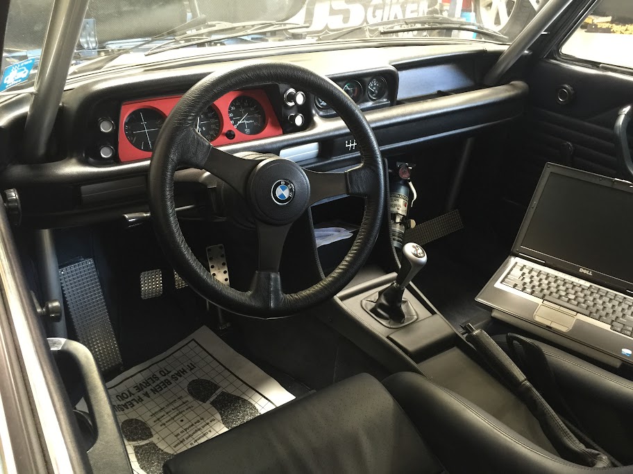

Mike at Autowave was tuning this bad-ass project car for one of his customers. A custom twin turbo 2002 with a slew of modern upgrades and carbon fiber, tastefully done with awesome details everywhere, I should have taken more photos, real car-porn material.

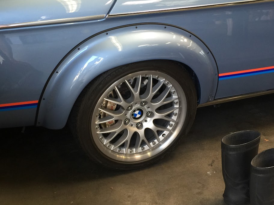

Very tasteful fender flares
