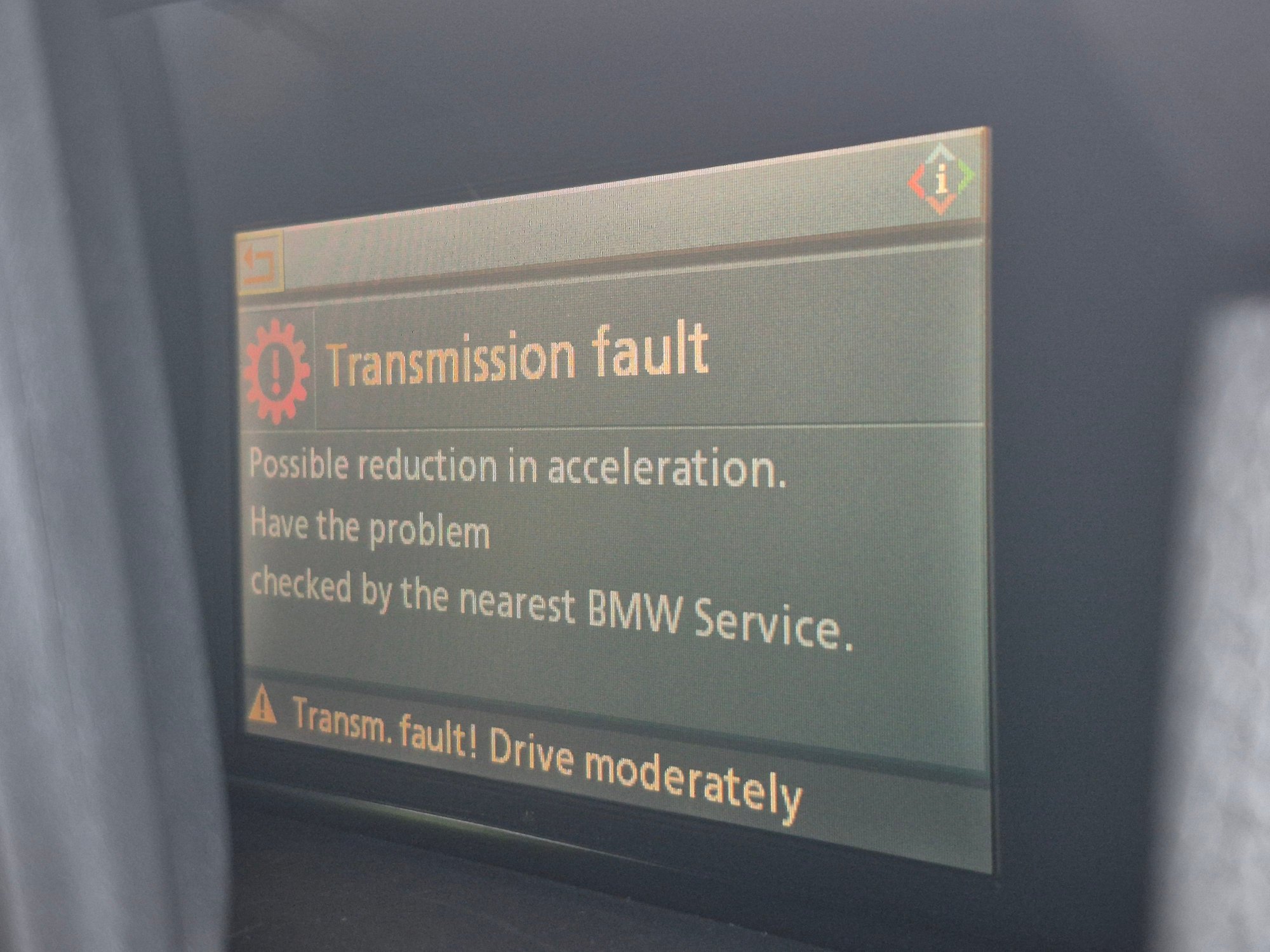

Now I have the above completed, I've been driving around the last week or so and 2 things are causing concern, just to add, I've done around 400miles since the work.
1 - when I come to a stop, the downshift in gears it jerks hard, more so downshifting from 3rd to 2nd
2 - when at 60/70mph (or abouts) or when I decide to put my foot down the dreaded 'transmission fault' message appears and the car goes into limp mode (3rd gear I believe)
With the work carried out, would I need to replace the solenoids in the megatronic (6HP19) unit to clear this up? or could it be something far worse?
Any help would be much appreciated!
Lastly, I am taking my car to the mechanic this week to plug in to check fault codes as well.
