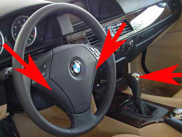

Hi, I want to change my steering wheel Trim from the (Black Plastic Trim) to the wooden Trim, and also the gear, I want to change it from the silver trim to the wooden trim, can any buddy help me, and show me how can i Do It My Self ?

You need to remove the airbag to get acess the trim acess.
Instructions: replacing_steering_wheel.pdf

Ohhh I didn?t expect that? Lot?s of work, and how about changing the gear trim !! Do I have to remove the Engine loooooool , Just kidding, and Thank you very much for the attachment.

I did not know that BMW has a wooden steering wheel trim available. I just bought the silver trim to replace the original black trim on the steering wheel. Here is what I did: http://forums.e60.net/index.php?showtopic=...2&hl=lcc014
Regarding to the shifter, BMW has a wooden one that you can buy and replace the stock one by pulling the shifter up (very hard). Then you insert and push the wooden shifter back in.

Yes. The only thing that most members concern about is the dealing with air-bag removal.
