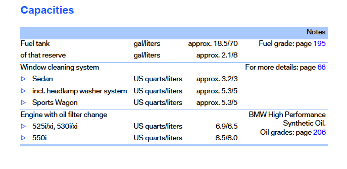

I live in Belgium (Europe) and have a 525i 2008 (facelift model) because we are used to use liters I added 6.5 liters as there stands in the manual. But I only see 2 blocks on the oil level indicator on the idrive it is green and it says ok, but shouldn't there be 4 blocks?
Could someone confirm that there should be 6,5 liters engine oil in the N53B30A ??

it takes 7 quarts?
Old Feb 10, 2011 | 08:49 AM
  #119
MiamiPhill's Avatar
Posts: 1,921
From: South Florida
Originally Posted by leese8080
Great pictures and descriptions. I plan to do mine every 7,500miles from now on.
it takes 7 quarts?
You will have to consult your owners manual on that, our engines are different.
