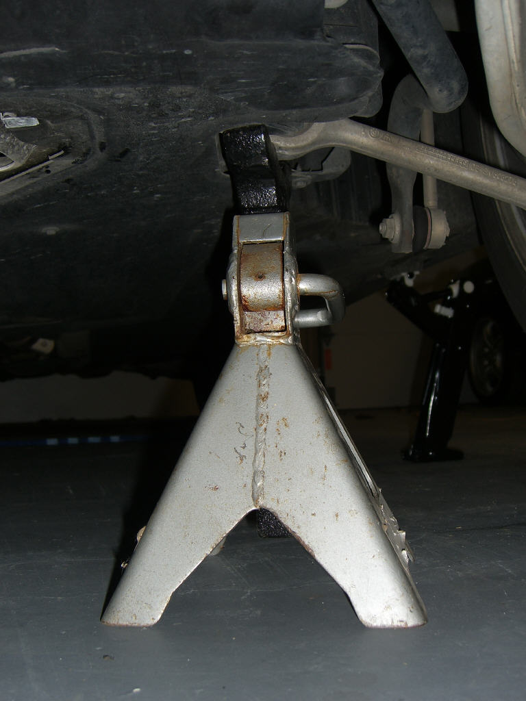

Originally Posted by RobertB
Also, in case it helps, this is how/where I raised the driver's side on my 530xi (note the jack, and jack stand):
Attachment 68217

Originally Posted by purin
hi
Is this the same place on a 535 that we should put the jack stand on?
There is a rubber block (maybe 1in x 3in between the oil cover and the front nose under the car that is not covered by the plastic shield. I ended up using the OEM jack and that rubber block for the jack stand.
It made manuvering under the car a bit difficult with the jack and pan there. I think I want to try a different spot for the jack stands next time.
Thanks
-p
The jack stands go on each side of the car right behind the front wheel. You will see the jack pads.

Please guys, do not rely on factory jacks for maintenance work. Use a floor jack and a jackstand before going under the car (along with other safety measures - level surface, wheel chocks, etc). For an oil change, get a set of ramps to drive up on.

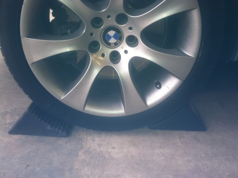

I drive upon my homemade wooden ramps.
Floor level is 26" long.
2nd level is 20" long.
Stop is 1/5" sq.
So, using a 2 x 12" x 96" long board from Home Depot at a cost of about $14.00 I have two excelllent ramps.
Place 4 rubber wheel chocks behind the two rear wheels.

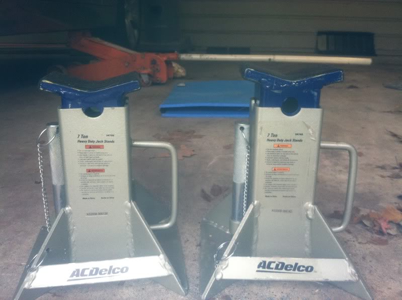

I then place 7 ton jack (AC Delco) stands under the jacking points below the passenger and drivers doors.
I then lower the car very slowly onto these two jack stands so that they take 100% of the load. (If you like, you can leave the hydraulic jack in place as added security but since I'm using 7 ton jack stands, I remove it.)

Remove the the rubber wheel chocks.
