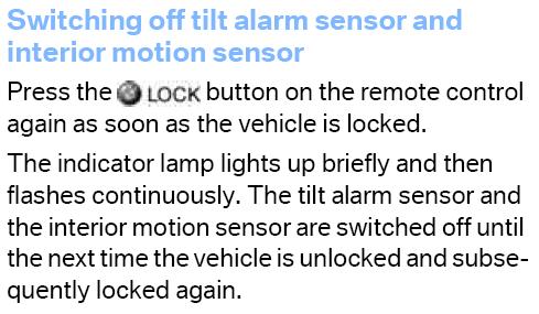

Old Feb 15, 2009 | 06:16 PM
Rudy's Avatar
Posts: 17,310
From: Pittsburgh, PA USA
My Ride: G30 M550i
Model Year: 2018
From the owner's manual...not that anyone bothers to read it...
