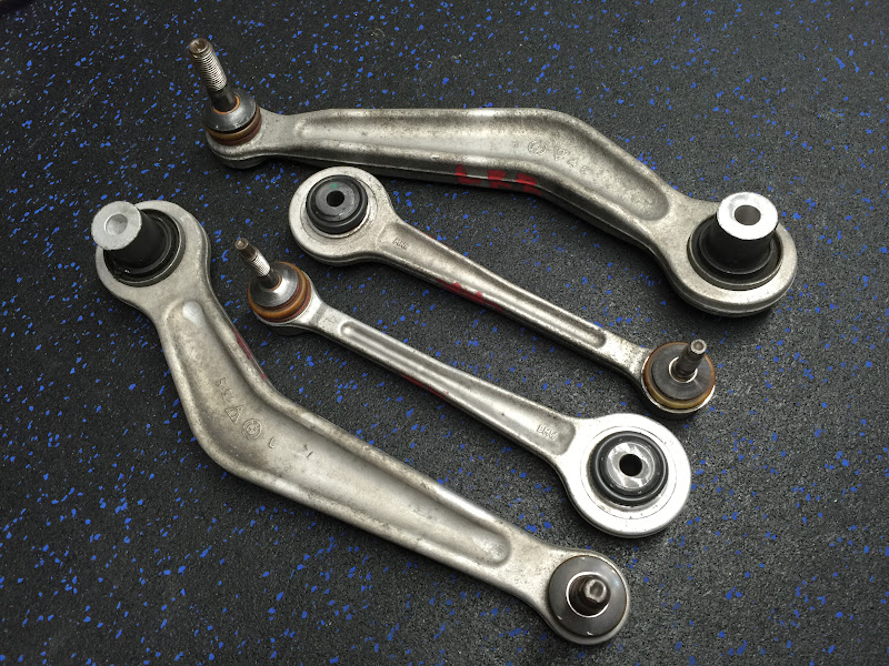

Cross referencing part numbers on Realoem to make my suspension M5-Spec.
More M5 goodies for future projects...
Delphi coils replacing the oem units
M5 rear control and guide arms, as it turns out the control arms are exactly the same as what I already have, the smaller guide arms have beefier inner bushings. Next will be the rear integral links and front lower control arms and all suspension will be M5 spec (or better).
Left: 535xi Right: M5
Service manual says to deflate and remove air bags before replacing the guide arm. This can be side-stepped by jacking up the steering knuckle which will more the air bag enough to get the top bolt out and back in.
