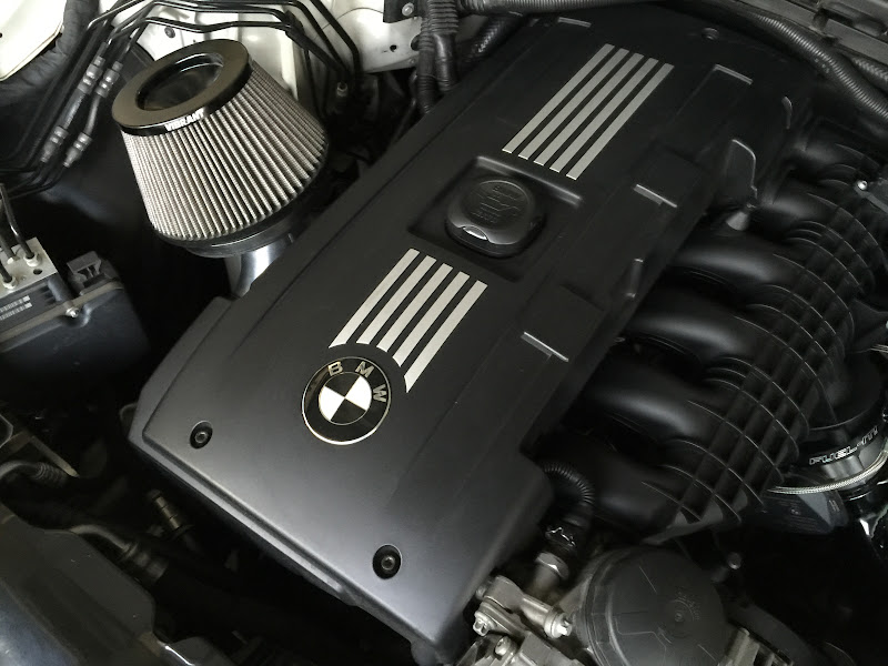

Count 'Em!
Before
After, I bugs me that it is round peg in a square hole but I will leave it for a bit and see if I get over it or if the aluminum cap gets the axe.

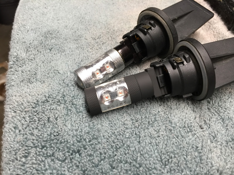

Who mods their LED bulbs? ME!
I already had a D2S sealant/plug installed on the housing, the plug for the H1 bulb was too small in diameter to fit the whole, what to do?
Put the plug in the plug!
It came out super clean on the inside as well (and double sealed)

Installed
Oem oil cap
Aluminum cap, a little bit of a round peg in a square hole but it doesn't bother me enough to change it, so it stays.
