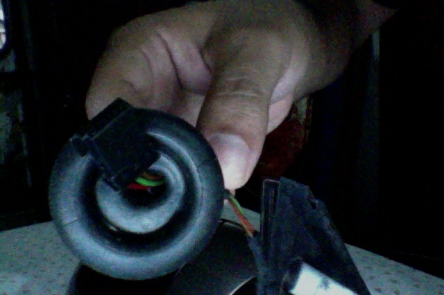

prod date 2007-12-05. and this is the plug

You should be good to go! Congrats on the awesome mirrors!
