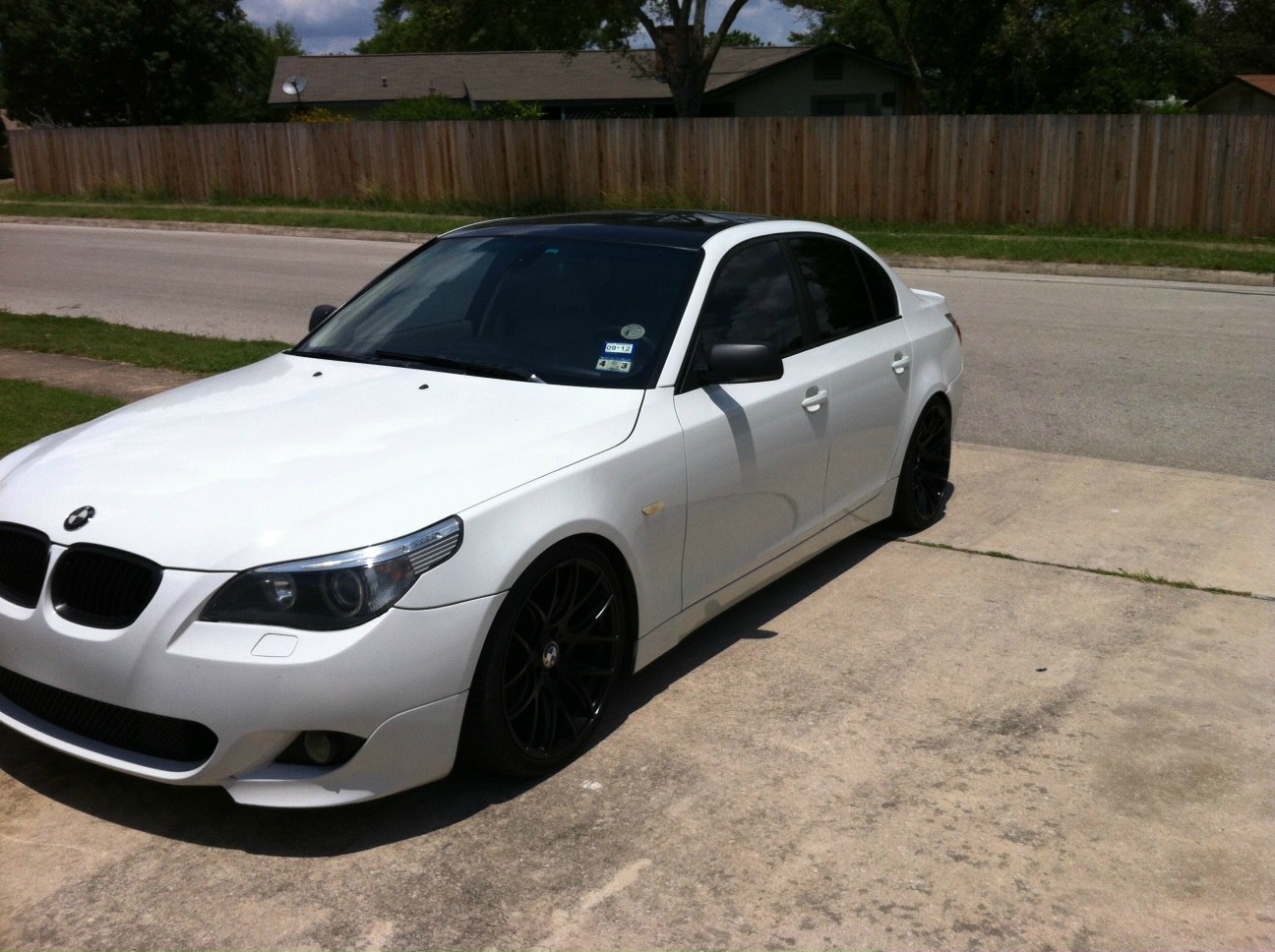

My mirrors came out very smooth.

First thing I've used it on but I think for good results, do it inside a area where there is no dust. I started to do it with the garage open and it got dust all over when wind had a gust. So I had to remove all of it and start from scratch. I applied a first thin coat with it very clean, I kept added coats every 20 minutes. They have about 5-6 coats on them. Turned out with no imperfections surprisingly.
From watching the videos from dipmycar, he recommends moving the masking right after you spray, otherwise it will bond to the tape and it will rip when you pull it.
