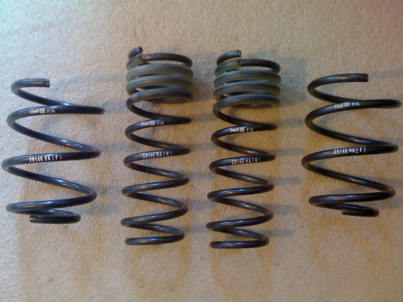

Took a pic of the springs after unpackaging them. They are in excellent condition, there is no sign of coil bind on them. The person who I bought them from did not cut the jounce bumpers and I don't think I will either. I would rather just go back to factory if I think the ride is that bad but i've driven many H&R VW's and think I will be able to tolerate the ride.
I measured them and the fronts are 21cm (8.27") and the rears are 33cm (13"). The rear spring are designed with the dead coils at the bottom so that when your car is jacked up the springs aren't loose. These coils are designed to be at full compression at load.
Talked to H&R yet again and they still insist on leaving the bumpers alone. By cutting the bumper you change the rate of the spring since the jounce bumper is a progressive helper spring which is supposed to be used in conjunction with the coil spring.
