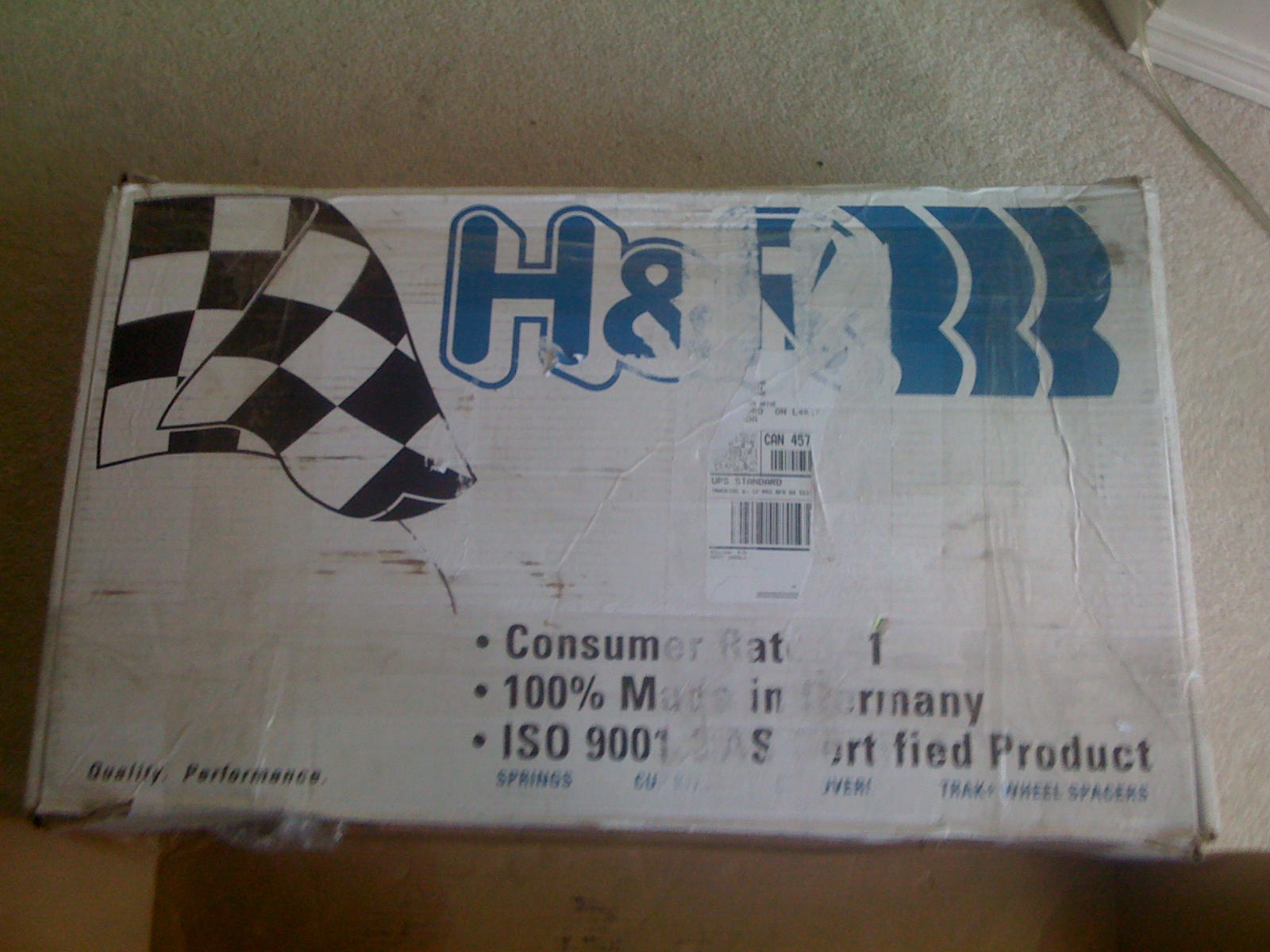

Just got my springs, too bad my mechanic is gone for the month on holidays! I can't believe how short 2 of the springs are, would those be for the rear?
