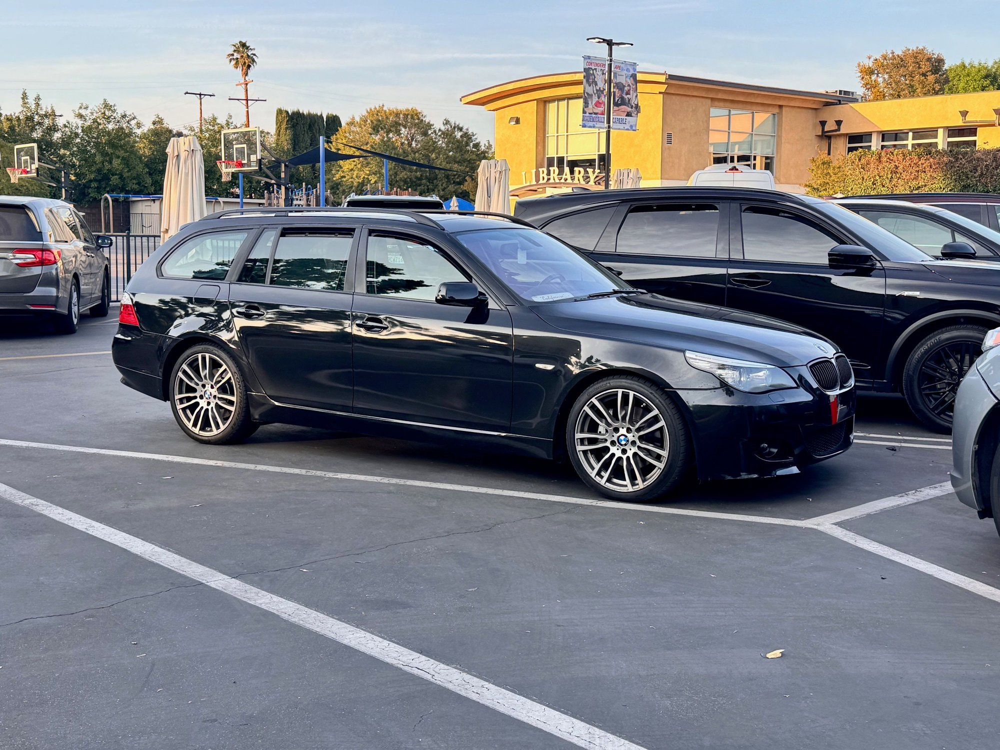

Purchased at 141k Miles with Check Engine Light, missing PDC Sensors, AWD issue ( not bothering mine )
Quick to it - want to do a Semi m5 conversion but -
Rwd Conversion - im halfway done
Keep the Auto 6 speed - 8hp later down the line?
Outside M Sport Aesthetics
M5 LSD w/ Axles
M2/M3 Calipers w/ m5 Rotors - documented on youtube
The N54 has been around for quite sometime. I want to stay within OEM parameters so I will be using the Stock turbos. So lets see what we can do with this frankenstein build but to the unseen eyes just looks like a M Sport 535i.
Current config
Rebuilt Turbos
AWD drivetrain is removed but not coded - Front Axles but Hubs still connected, Front Diff, Front Axle - Evans E61 has it documented on how he did his
High Flow Inlets / Outlets - had to massage the Aluminum Coolant Pipe for the O2 Sensors
Catless Down Pipes
3inch Exhaust with Vibrant Resonator, High Flow Cat from Ebay 200 Cell - stinky sometimes - bearable , Using a 3inch Vibrant Muffler with dual tips built in and still drones
^ Anyone that has single exhaust with muffler chime in, i might swap to a valvetronic muffler, be nice to sound like the e90 w/ PE.
TurboSmart BOV
Burger DCI's
XHP Stage 2
MHD Stage 2
Bmw Style 403M Staggered - Wheels little sunkin in, itll do for now, would love to put the m5 multispoke wheels on.
HR Sport Springs Front - did not adjust the air spring settings. Used these chinese shocks for 110 bucks. Feels like coils but was better than blown shocks.
Issues loading pics at the moment but lots of inspiration from Evans car but car needs to be on quieter side and with some bling on it. Right now im dealing with at 4k rpm sounds like a whoopee cushion, im pretty sure its coming from the High Flow Outlet from the clamps for the silicone hose but will confirm.
