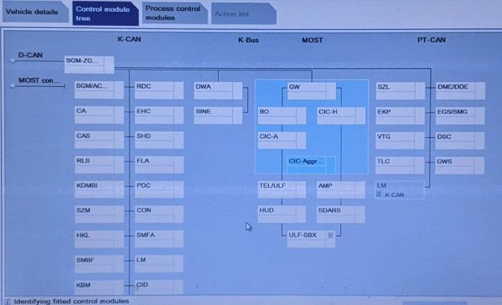

When running ISTA-P, it starts off showing control module as below
and then once complete, it shows as below
Old May 15, 2022 | 11:07 AM

Originally Posted by pavjayt
Can someone tell me why I am not able to find any of my 63, 62, A0 modules ZB numbers in winkfp?
Imported data into winkfp multiple times from V67 with no luck.... none of those 3 show up in the list.
Yust guessing maybe your cic flashed with non e60/61 data.
Old May 15, 2022 | 11:25 AM
  #55
seanjordan20's Avatar
Joined: Jul 2011
Posts: 3,953
Likes: 361
From: Augusta, GA
Engine: 3.0 B58; 3.0 M54
It needs to be reflashed. Ensure your VO is correct also. What version of ISTA are you running.
