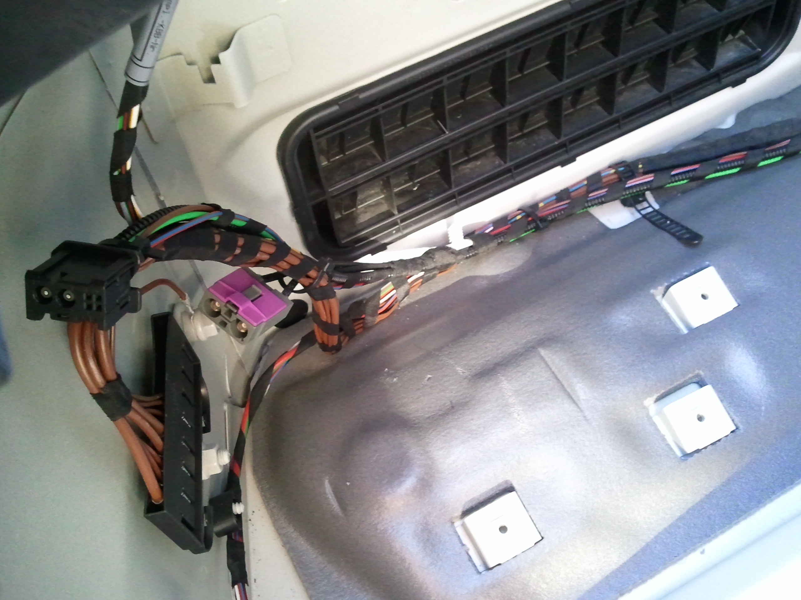

Right now I have the standard small idrive screen with bluetooth but no nav. The car was made 7/2005.
Just wondering if any of this means the car is prewired for navigation? I'm not really sure what any of it is.

Give your chassis number to the dealer and they can tell you, the nav is fitted in the front on the e60, not the boot

The first picture is the pre-wire for Sirius satellite radio. The next two pictures look like the telephone module and stereo amplifier.
I don't believe any of the E60s are pre-wired for navigation after the early 2004 cars. You can still retrofit navigation- here is a thread with the details.
