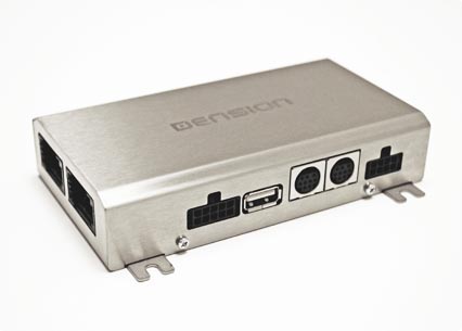

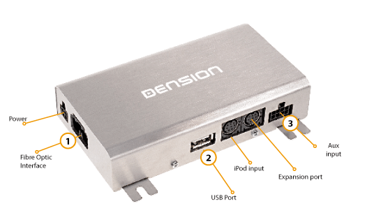

Hi guys,
Can the people who did the CiC retrofit and have a Dension 500 help me figure something out?
It seems Dension Gateway 500 has several versions that are all called the same but are different in several things. The old one has 4 dip switches while the new one has 6 dip switches, also the it seems the MOST connection plug is different.
Can you tell me what you have:
- Does your Dension still work after the retrofit
- What Dension 500 do you have
- What is your MY
I've been in contact with the Dension people and I'd like to verify if the new version works for the CiC while the old one doesn't.
Thanks
Old: CIC Retrofit Installation LOG-gateway500-1.gif
New: CIC Retrofit Installation LOG-gateway500-2.jpg

Originally Posted by brosken
Hi guys,
- What is your MY
Thanks
Mine is the new one on your picture with 6 dip switches. I have a LCi Aug 2007 E60.
As I said in post #473, I am having some problems after the retrofit:
I am able to hear the music from my iPod, but the screen doesn't show the artists or song name or album. It just goes on an infinite loop with the status bar thingy, and a greyed out line saying "please wait..."
This is when I set the Dipswitches to #1,2,6 as per Text enabled E60.
Then I tried to use the configuration for E90 with iDrive-4 (#2,3,4,6). Same.
The only setting that seemed to work is the Porsche PCM config (#2,3,6)! While most functions work, I get an "unknown artist" at the top row where the artist is supposed to be....
When I am at CD1 (Scan Playlists), I click it using the new controller, and it shows my playlists. After selecting Playlist 1, for example, it starts playing the first song in it, but doesn't go to the song list. I have to separately press and hold the Forward button (Down arrow on the right side of the steering wheel) before it will get me into the songlist.
Great that you are contacting Dension, cos they have not replied me. Please post any new info which you may have! Cheers!
