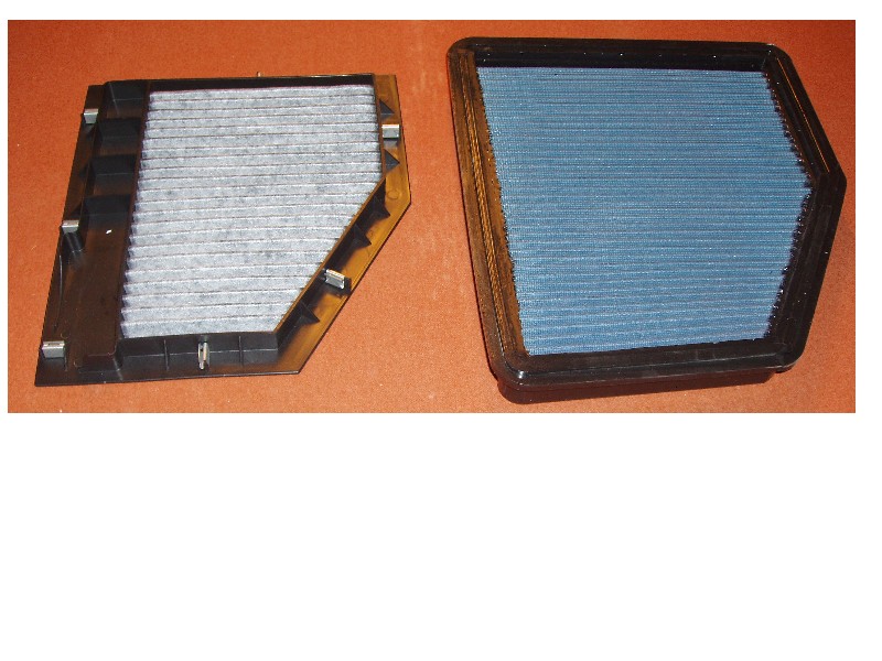

Checked with the installer and the air does not come from the brake duct but behind the front bumper. I do not remember what the old set up looked like inside the grill, but this one appears to come down in front of the radiator and go through the bottom to get behind the bumper. He explained that Dinan did not want any turbulence coming into the air box that would interfere with the flow. So, this is pretty cool air being sucked up and passed in the conduit in front of the radiator before it goes over. Dinan has this to day about passing it across the top of the radiator: "Air from the secondary inlet passes through custom molded ducting, including a visible section manufactured from carbon fiber, also designed to reject underhood heat and provide maximum flow." There is a definite difference in the look and feel of the carbon fiber duct.
There is a pretty good difference in filter size. Compare the Dinan filter size to the original charcoal filter I had removed from the first air box.

I think the size of the air box may be to accommodate a larger filter with less restriction per square inch.
