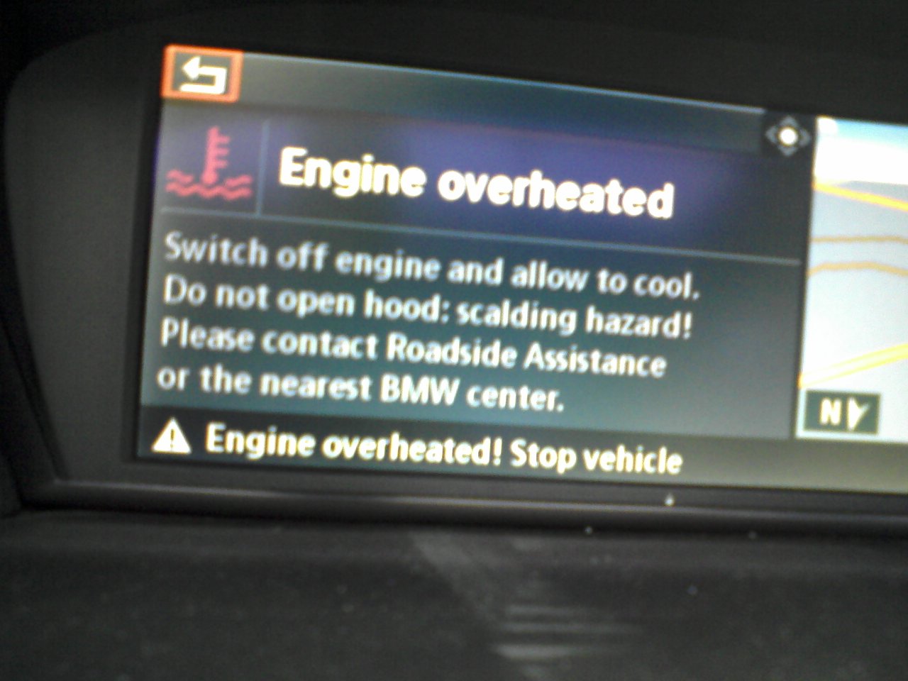

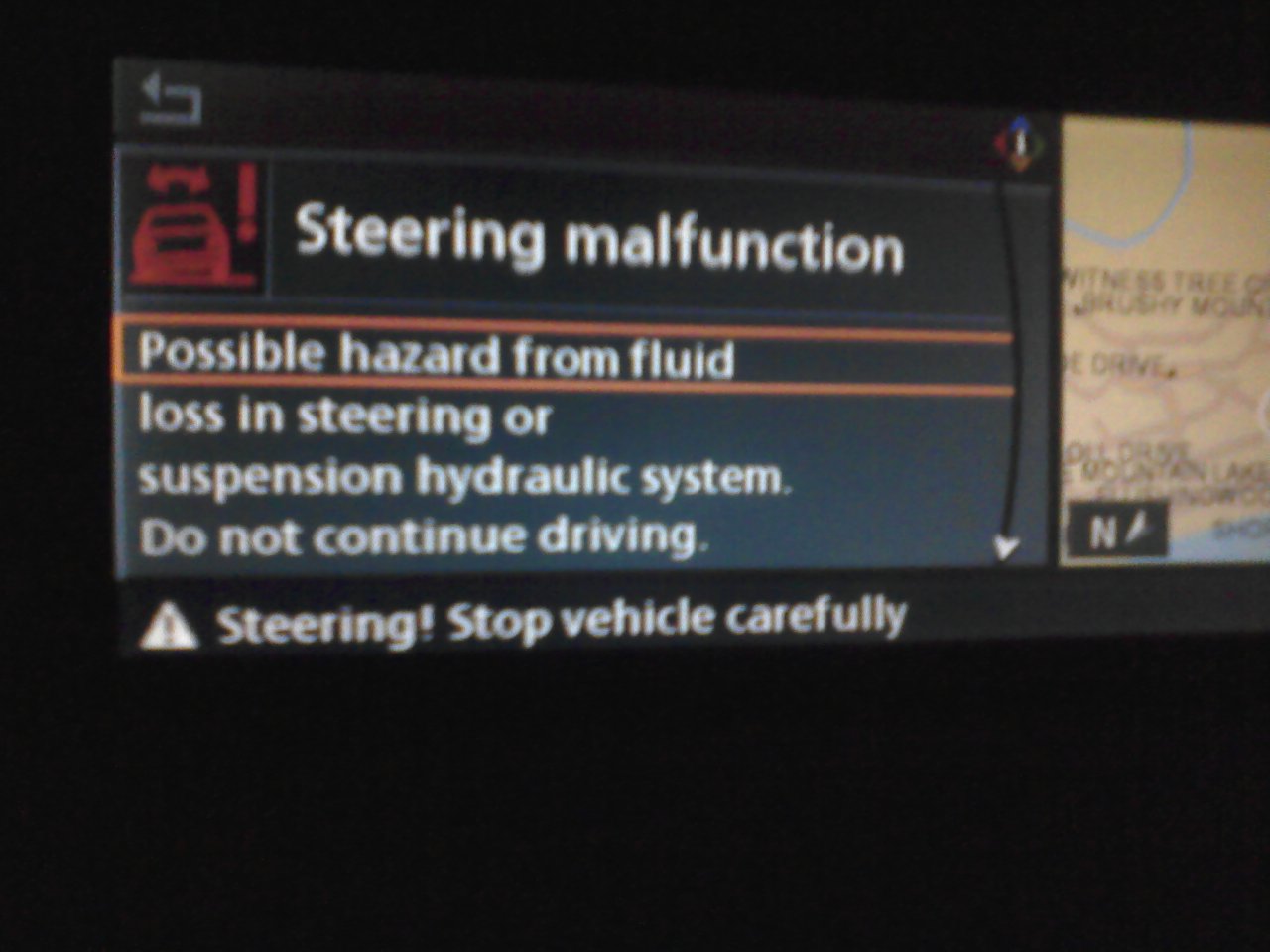

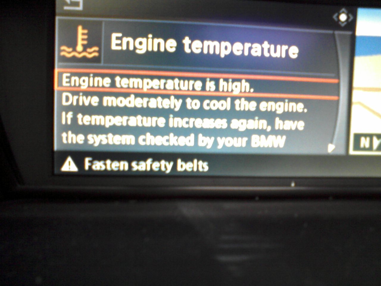

Hi Everyone,
I just purchase my very first e60 (used) and it is turning out to be a nightmare with this car. I just car back from the dealer for a rattling noise which they thought was the vacuum pump but it was not, problem still exist they will be now be replacing the Active Steering Pump... Second issue was the NAV would freeze and the dealer replace the heads up unit which now needs another part to be replace. With that said after the replacements of those two parts they had to do a bunch software upgrade. I drove the car home and went out again 45 minutes later and I go two very interesting surprises.
I get a Engine overheated message on the iDrive.... See Pics....
Then I tried to close the sunroof and it would go all way to close but then it would open half way.
Wondering if anyone out there has experience any of these issues after a software upgrade...
Attached Thumbnails VERY DISAPPOINTED WITH E60-0724070603.jpg   VERY DISAPPOINTED WITH E60-0803071848.jpg   VERY DISAPPOINTED WITH E60-0803071857.jpg

Aside from the rattling noise that you mentioned, it sounds like most if not all of your other problems may just be software or electronics related. Unless the car really did overheat, it's likely that all of the iDrive messages you posted may be false alarms. The sunroof issue sounds like it simply needs a reset or reinitialize (click here to be taken to a topic that will help you with this).
These cars are incredibly complex and many of the systems are reliant on other systems. If you're dealing with a dealer that isn't completely up to speed, their actions can trigger many additional issues that might be the reason for the different warnings on the display screen.
