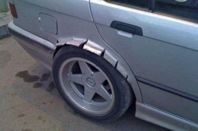

Originally Posted by 530i6spd
make sure you go to a good reputable place though, some shops chip your paint from their lack of skills
+1
