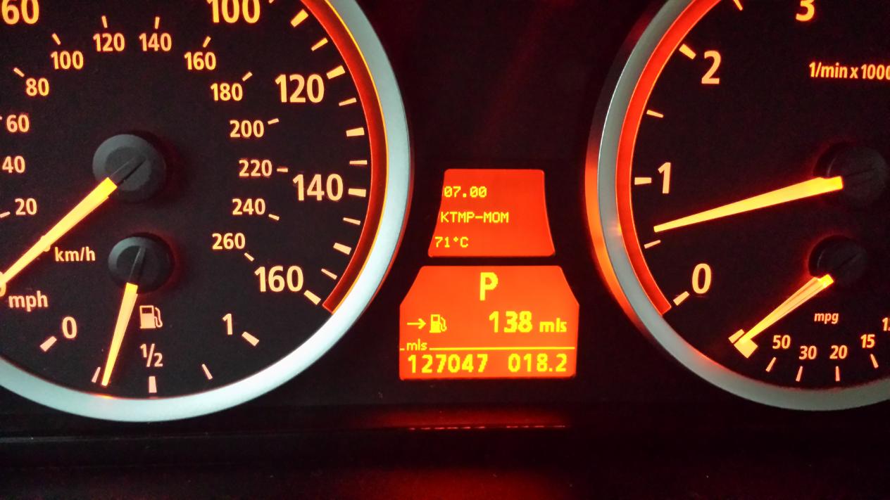

Well here's the update....im thinking maybe my thermostat could be open because my coolant temp is 48 deg when driving at 60 mph for about 25 min with no stops, but when i stop and the car idles i get about 71 deg what do you think??

This is a picture of my car idle....71 was the highest it got after driving around for about 25 min at 60 mph
How did u get that to appear there? I haven't learned that trick yet.
