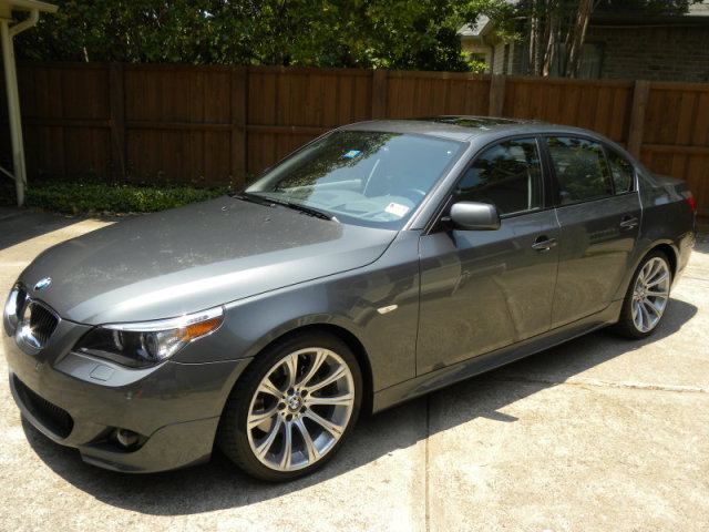

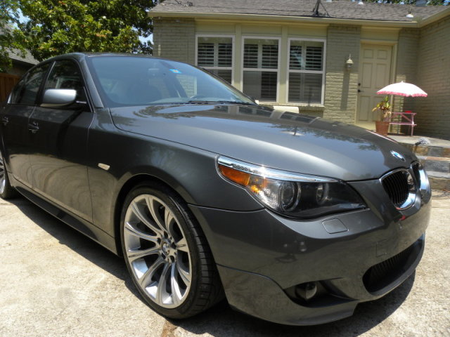

My 2007 530i is still in practically showroom condition but I noticed the headlights might be getting a bit or oxidation and wear and tear on them.
I know I can try a headlight restore product (unless you guys who know don't recommend it) but if I decided to just buy new OEM headlights I was wondering if the 2008-2009 E60 lights will fit just the same? The 08-09 removed that amber lens on the side so I slightly like the 08-09 more.
I'm not too familiar with modifying stuff like headlights, etc. I like to keep a nice clean OEM look so in case this matters for your answers, the car has the full OEM M Sport Package on it.
Here's some pics.
Thanks!

The headlight will physically fit but wiring is a whole different story ... then re-programming ... among other things...
At least if your car build date is late '06 you already have a newer light module.
