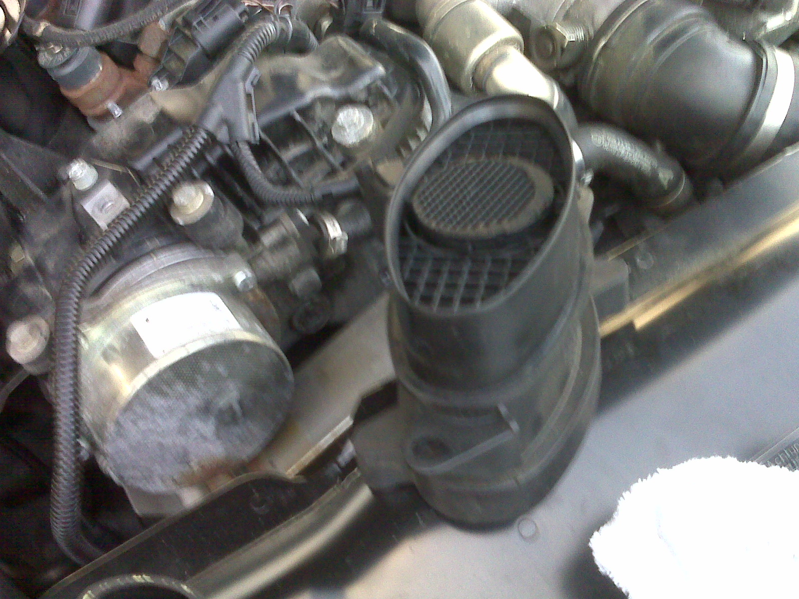

Not sure how much day light I've got left at the moment. First time I've had a look at the MAF / Engine side of life. Heres a picture of the MAF:-

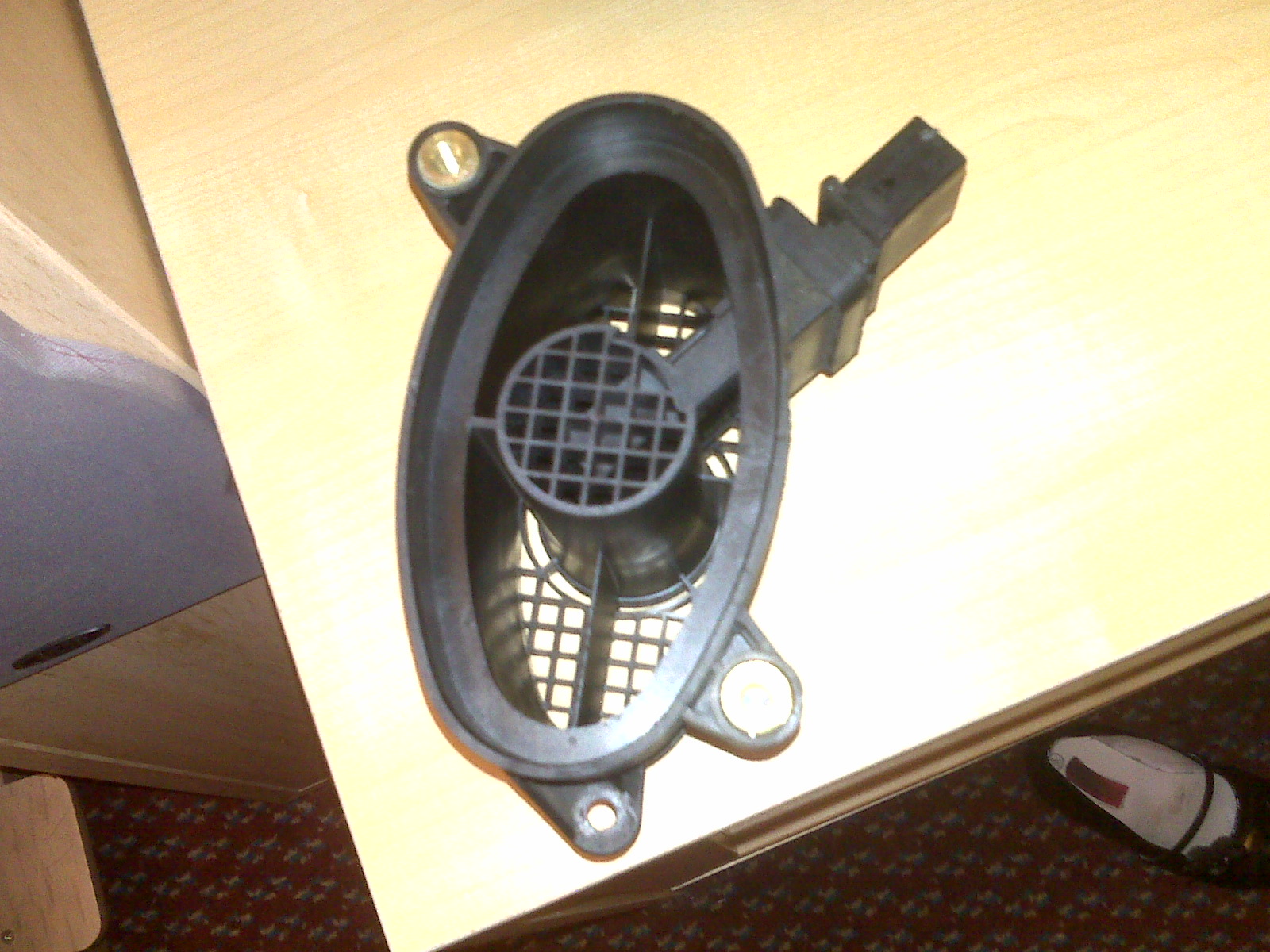

Heres a front side with the Air filter exposed:-

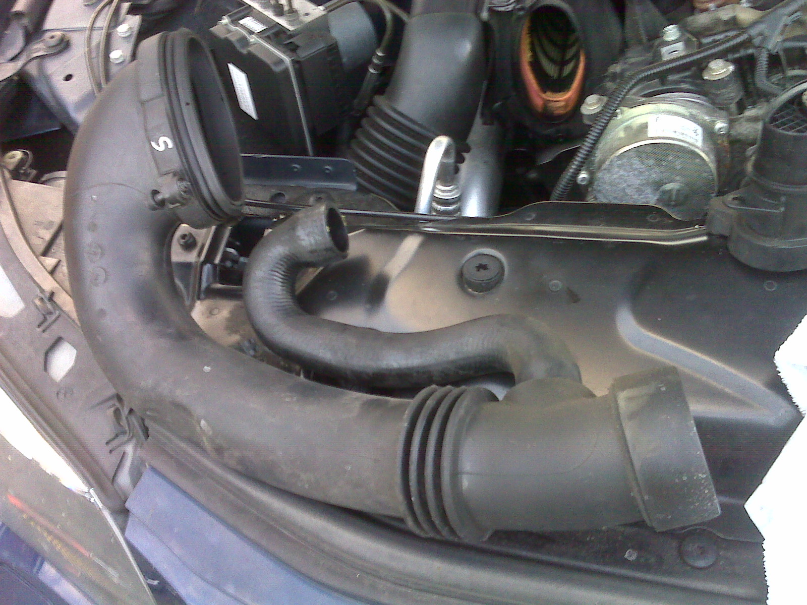

On the picture above, underneath the air filter there is a pipe (which seems to have some oil in it), Does anyone know what it is and what it connects to via the pipe pictured below:-
Hopefully I'm trying to make this a learning experience. Thanks
What car is that? Can you take a picture of where you plug in the connector to the MAF sensor?
Attachment 52068
Attachment 52069
Now, underneath the air filter there is a pipe (which seems to have some oil in it), Does anyone know what it is and what it connects to via this pipe below :-
Attachment 52070
Attachment 52068
Attachment 52069
Attachment 52070
