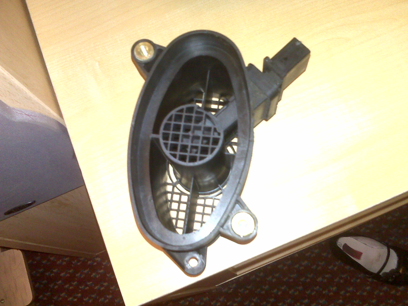

I sprayed the Cleaning solution through the centre grill of the MAF from the air intake side.
Is that correct. I don't have to spray further up where the wires lead out to the MAF connector do I ?

nope you do not.

Ok.
Put everything back together this morning, but I don't notice any real improvements.
Does it take the system a bit of time to re-adjust to the "cleaned" MAF or should the results be instant ?

Update :
Took it for a spin earlier and it did not seem to have improved much. Took it for another spin and she is running alot better, almost to her old self.
