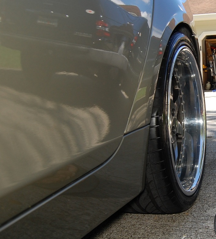

I have 20'swith a 285/30/20 tire, 10mm spacers to give an aggressive offset, and fenders rolled with OEM sport suspension and never rub on the deepest of dips with passengers in the car. I also have had all the OEM wheels mentioned above with the exception of the 166's and never rubbed with spacers either, and that was without rolling the fenders. It is all about the correct spacer, tire choice and ride height . Here is a current pic of how my tire looks with a 10mm spacer and 20's. I haven't had a problem yet.
