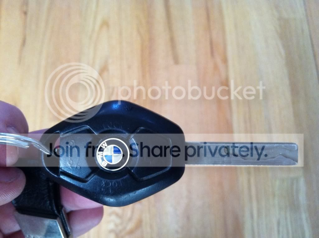

That looks like a CA fob to me (i dont know)... I dont have it and my key looks like this:
It's not a CA key. It would have a removable battery door on the back of the key. Your key is pre- push button start. My CA 550 has the battery door, my brothers nonCA 328 sport does not.

You do not have comfort access. Just a regular key that has to be inserted in the car for it to start and charge the key. Its possible the battery in the key is too old and can't hold a charge or it's not being left in the ignition long enough for it to charge completely.
THANKS FOR THE REPLY, SO THIS MEANS I NEED TO GET A NEW KEY PROGRAMED INTO MY CAR. DO YOU KNOW IF I CAN GO FROM A NON CA TO A CA? THANKS

Well it all depends if your car does have the CA Module and the antenna. CA is not standard on these cars and it is an added option. So here is what to look for you can see it not a simple thing. BTW- if your car is not equipped with CA when was built you CANNOT add it later on and it is not just matter of programming!
