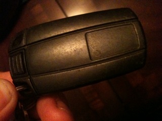

hi there, i have a 2007 525i and only have one Fob or Comfort Access Key. the key starts the car but my unlock/lock or trunk does not work? does anyone know why? my friends key is just like mine but his looks like theres a little sliding cover on the back but mine dosent. and nother thing how do i know i have the sports package? thanks all

IF you have comfort access the battery is easily replaced. If not, the battery charges when inserted in the key slot. If it's the latter it's possible the battery has become discharged and needs some drive time. If it's CA (Comfort Access) replace the battery and see if that helps. Instructions are in your owner's manual which you can also download one from the Information section of this forum.

Thanks guys, ill see if i can get my fob to open up. one queestion do you guys know if every key has a battery? i was told by the previous owner that it was rechargealbe and i had to buy a new one? does that sound right?

The "Fob" is recharged when inserted into the slot, as far as opening it, I never had to open one. There might be other issues going on with your CA, do a search and read!

Key fobs are rechargeable in the slot if you do not have CA. If you have CA, the fob has a replaceable battery. Mine lasted around 2 years before I needed to replace the battery...

My key looks a bit diff from the video

You do not have comfort access. Just a regular key that has to be inserted in the car for it to start and charge the key. Its possible the battery in the key is too old and can't hold a charge or it's not being left in the ignition long enough for it to charge completely.

If your's has a removeable battery.... to access it, first remove the key, and then pry it up with a screwdriver. It's really quite easy - you don't have to worry about breaking it. If it doesn't come up easily, then it's likely not the removeable one... and hence, not the Comfort Assist model.

That looks like a CA fob to me (i dont know)... I dont have it and my key looks like this:
