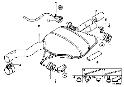

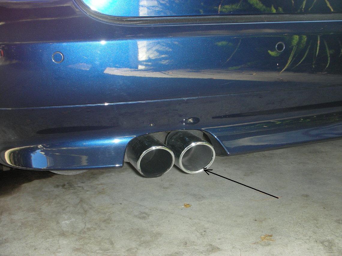

Is this a problem or is the right hand tip not really connected to exhaust system? It has never been cleaned and appears too pristine to have any exhaust gases passing through it. On Realoem it appears both tips are connected but are they really or is something broken?

Cobra, - that side of the tips has the exhaust valve which is closed by default (and opens when the engine is under load) so I would say it's normal that side is slightly "pristine" as you put it. Mine has the valve as well - but never had that phenomenon because I have 2 separate mufflers + I've fixed the valve in the open position !

In the US..the left side gets used...in the UK and Japan it is on the right.

On my aftermarket exhaust, both of my tips get filthy. I too, have a 530xi. However, I thought that on my old, stock one, both tips got pretty dirty too. Never noticed one being pristine and the other being dirty. They looked the same.

I duuno, Andy. That is true for the 550/545/535 exhaust b/c they have two mufflers and a butterfly valve. Looking at the realoem 530xi muffler pic that cobradav provided, I don't see a valve that opens and closes, I think that nickolas_g is right, only the left side is functional.

I would say it is not functional. Is it OEM or aftermarket? Get a coat hanger and see if the tip opens into the muffler.
