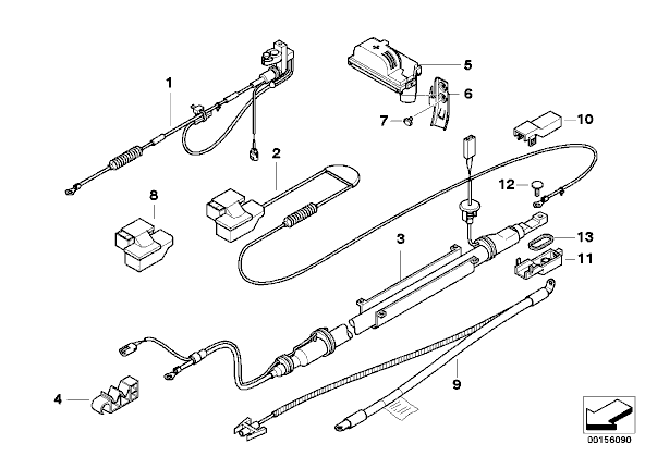

Originally Posted by madoon' post='535040' date='Feb 23 2008, 04:11 PM
to help you figure things out this is a link to the battery wirring set parts. maybe you can check them find out where the expolisive are supose to be,
http://www.realoem.com/bmw/showparts.do?mo...hg=61&fg=10
Thanks ,this helps allot !
#2 Is the + Cable that has the explosive in it. The one the guys that did a read-out told me to replace.
When I measure the voltage / resistance on this cable, it seems to be intact. !
#9 is the ?emergency? wire. If I disconnect it (in the state my car is in) Everything goes out.
#1 is the negative. But the price for this wire is extremely high ! 217$
Could it be this wire also has sensors / explosives in it ?
Maybe this one is broken instead ??

I'm pretty sure only the postitive lead has the explosives.
Take a look at the following post and the post right after it:
http://forums.e60.net/index.php?s=&sho...st&p=457364
Between the two posts above I think you'll learn a ton about the safety battery terminal...

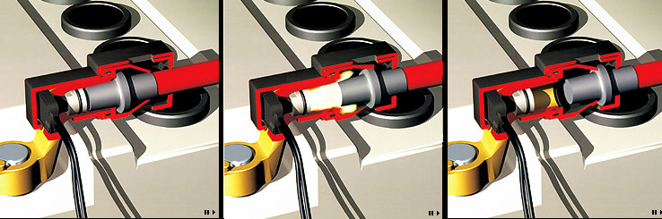

Thanks.
Judging from the picture, one would think that after the explosive has gone of, the cable will not let any current pass true it.
Then why is my cable still functional?

Originally Posted by flup3' post='535288' date='Feb 24 2008, 05:23 AM
Thanks.
Because there's a smaller wire that bypasses the explosive unit...
