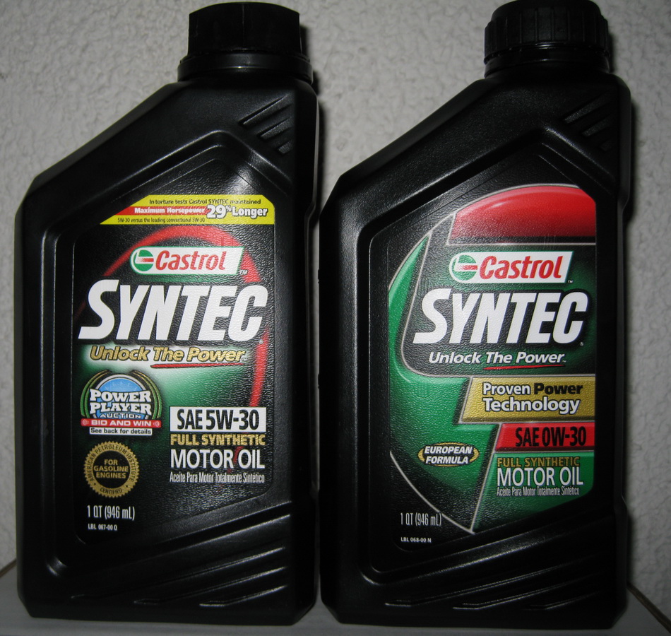

German Castrol (GC) is a TRUE synthetic Group IV. Made from PAO/Esters, not Group III(like Castrol Syntec 5W-30).
More here.
The other Castrol Syntecs are not true synthetics (the one on the left).
Other examples of true synthetic oils are Mobil1, Amsoil, Redline, and Royal Purple to name a few!
