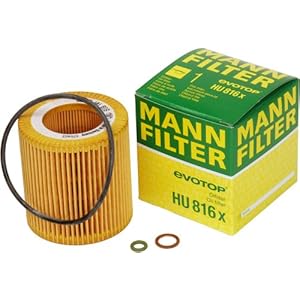

So I did ordered all the parts needed for my oil change and finally did it today. A little nervous at first, but it went rather smooth.
I ordered the cap removal wrench from Amazon. About $13.67+shipping. Worked like a charm.
Bought 7 quarts of Mobil 0w40 and Mann filter off Amazon too.
Got under car and removed the plastic cover. Unscrewed the 17mm bolt and let the old oil drain. It was pretty black.
Unscrewed the oil cap and the oil filter cover. Put everything back, INCLUDING ALL 3 WASHERS provided.
I DID NOT, however, perform the reset on the computer. It still shows that my next oil is due in 8000 miles, so I figured it was okay to just leave it. Am I okay to not reset the computer for now?
