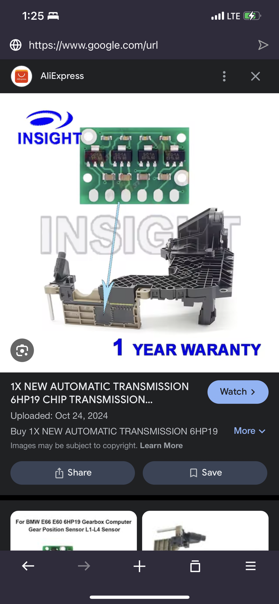

Check the neutral Safty switch is located inside g be transmission the gear shifter moves it am very sure that ur case cos I sorted that same problem today in my e60 530i it took me 5 days to figure out what the matter was but now I can see PRND on dash and the car starts on P
