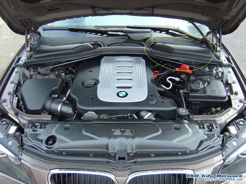

[quote name='E60Sim' date='Oct 31 2005, 09:27 PM']
Where is the micro filter located ?? Mine says 11.000 km's left before it wants a new filter...
[snapback]191469[/snapback]
[/quMines right hand drive its between the windscreen and the eng compartment if that makes sense on the right hand side you'll see a small button attached to it , it is the bonnet open warning device there's a good thread with a pic on how to open it on here in the DIY sect under air filter
[/quMines right hand drive its between the windscreen and the eng compartment if that makes sense on the right hand side you'll see a small button attached to it , it is the bonnet open warning device there's a good thread with a pic on how to open it on here in the DIY sect under air filter[snapback]191483[/snapback]
ahhr!! Found it in the DIY !
It must be this one ?
Originally Posted by E60Sim' date='Oct 31 2005, 05:46 PM
Attachment 12016[quote name='E60Sim' date='Oct 31 2005, 09:27 PM']Where is the micro filter located ?? Mine says 11.000 km's left before it wants a new filter...
[snapback]191543[/snapback]
[/quote]Yes, this one and the other same box at the left side.
Easy to open with a screwdriver (plastic bolt)
Take care of the filter's notches, to avoid up-side down fitting.
