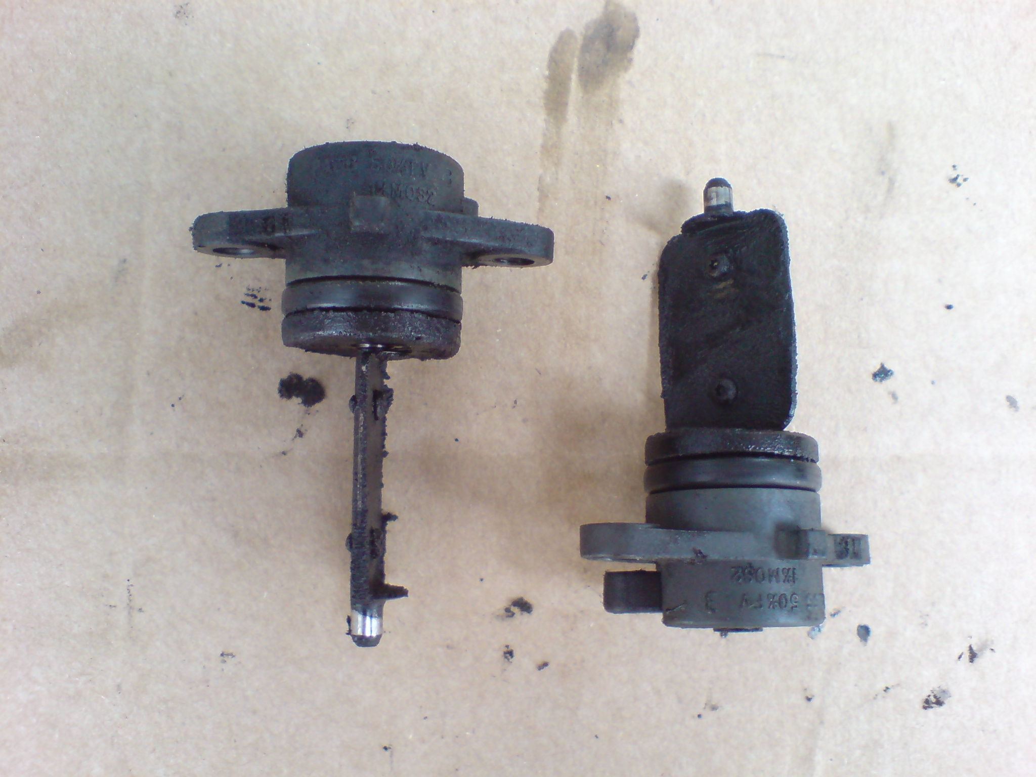

I've been in contact with a fellow BMW owner who purchased his 525d 2004 e39 touring at this summer. As a rational guy, he got his swirl flaps removed at local dealer (yes they do the removals in many places here). The car has done 160 000kms (99 400 miles).
He or the previous owner had never had any engine related problems (or that's what he's been told), and that's why the result was quite surprising!
- One swirl flap completely gone, lost, disappeared! They weren't able to find it or its reminds anywhere! How is this possible anyway?
- Four swirl flaps looked like in the following picture. The axle broken, one of the two rivets holding the flap gone.
He asked me to tell about his case to spread the word among fellow diesel owners. He obviously advises everyone to get their flaps removed!

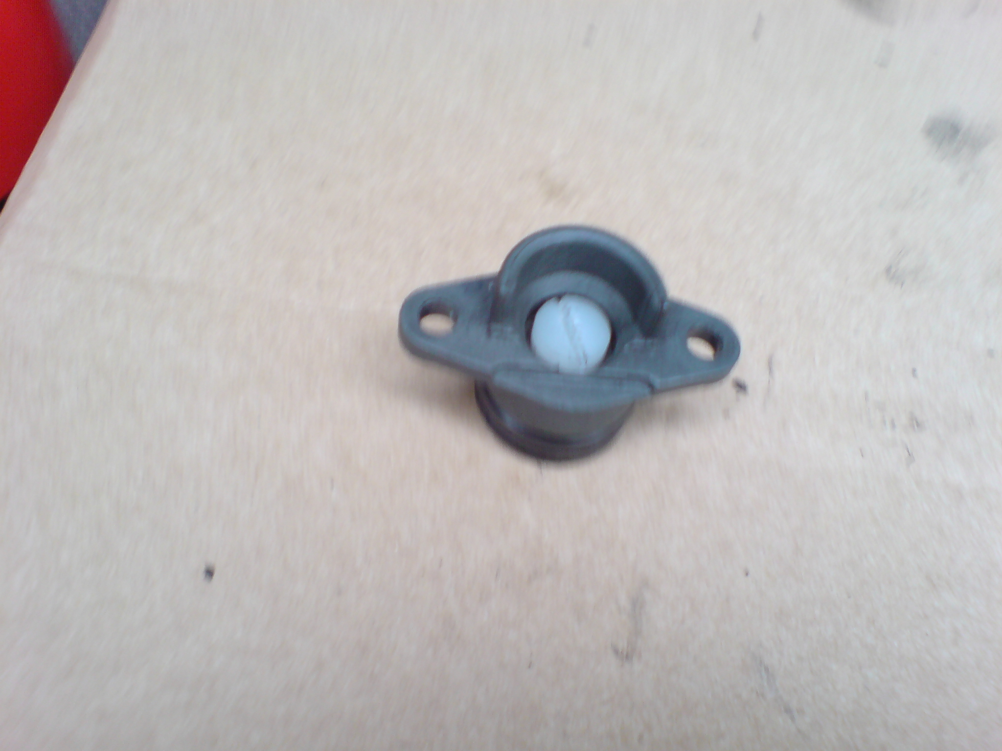

Thanks to Anzafin and all of you other guys I had decide to remove swirl flaps on my e39 530d from 2003.
My swirl flaps are quite different then one from e60 model.
So it was easy to do this operation.
This is how they look after 115000 km on my vehicle.

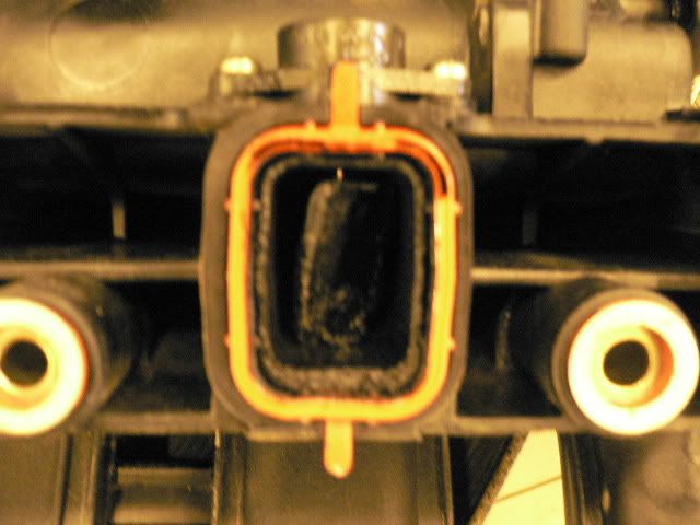

Also, I've made some changes. Insted of M5 10mm screws I've used industrial plastic screw (industrial plastic is used in some heavy duty machines)
And It looks like this at the end.
Now, engine is running nice....

Congratulations! Your plastic screw method looks very nice and clean!
Actually the swirl flaps in your e39 look the same as in an e60 that doesn't have the particle filter. Only the newer "updated" swirl flaps look different. Like mine, because I have a particle filter.
Anyway, good job there !
